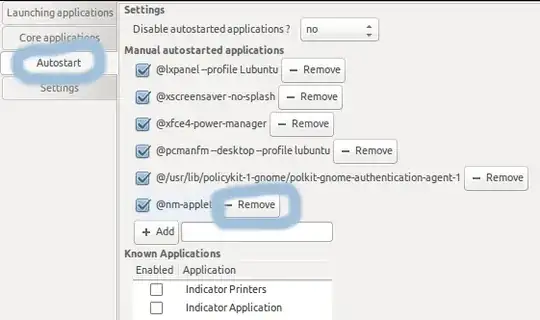

For Lubuntu users only:
From the main menu select Preferences > Default applications for LXSession. In the window that then appears, click on the Autostart tab, then click the remove button next to @nm-applet in the section Manual autostarted applications.
"Default applications for LXSession" window
Log off then on again, and there should now be just one icon.
