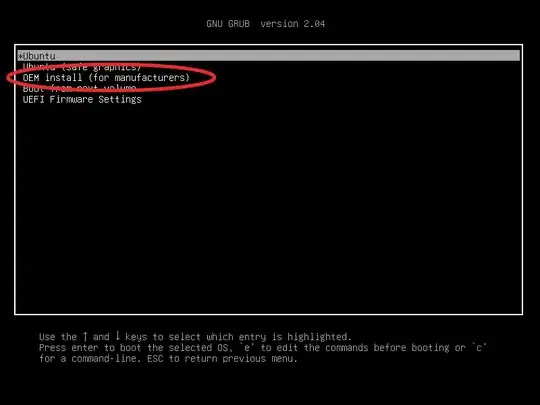

Make sure to boot from the installation USB in the UEFI mode. You will see the screen below. If you don't see this grub menu, then you did not boot in the UEFI mode from the USB.
Select OEM install (for Manufacturer) as shown below:
