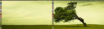

From webupd8.org it seems there are 2 options. (copy from the website plus some extra things added by me):
The default Ubuntu Appearance settings doesn't let you span a single large wallpaper across both monitors or use a different wallpaper for each monitor, but there are two applications that you can use to do this.
  1. The first one is SyncWall. Install it in Ubuntu using the following commands:
    sudo add-apt-repository ppa:nilarimogard/webupd8
    sudo apt-get update
    sudo apt-get install syncwall
    Here's how my desktops looks like after using SyncWall:
