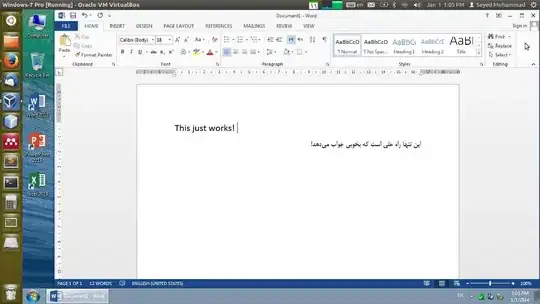

Here is the bitter truth: Office solutions for Linux are total failures! I've been a full-time GNU/Linux user for many years and I've constantly searched and tried different office solutions, from the old Open-Office, to the later Libre-Office, Abi-Word, etc... They have all failed to help me do my office work. It even gets worse when it comes to non-Latin languages (right-to-left languages like Persian, Arabic, etc). The user has to fight with these software to get his/her work done! And Microsoft office compatibility is just not there. I can talk hours and hours of how much I've tried and they have all failed me, but this is not the point of this question.
I've also tried installing and running Microsoft Office using WINE, and some-how successful but it didn't work-out nice and it mostly crashed when I tried to open my office files.
LaTeX is fine, but it's not an office solution. LaTeX is for type-setting, and it's more like a pro's tool, and there's no spread-sheets, nor presentations.
So what's the solution?
This is not a command-line solution. The only solution that I have came up with in all these years, to keep me inside my GNU/Linux OS and also get my office works done, is to use a minimal Microsoft Windows installation in a virtual-machine (like VirtualBox) and install a Microsoft Office suit.
It might not sound pretty but it's the only solution that works flawlessly and saves me from fighting with bad-office-solutions in my precious time. At first, I myself thought this was not a good solution, but after failing with all the others and doing this VM stuff for more than 2 years, I'm really happy with it :)
NOTE-1: I'm not advertising Microsoft products! Just trying to help solve the problem and move-on with life.
NOTE-2: As emphasized above, this is NOT a command-line solution. So why post the answer? Because it's a TESTED and WELL-WORKING option! If no WORKING command-line solution is available (which I highly suspect is the case), then having an ALTERNATIVE option is better than NO options.

    Why just use MS word in `wine` instead of virtual machine ? – totti Jan 01 '14 at 10:12
    As I mentioned, my experience with installing and using MS-Office using `WINE` didn't go well. The program didn't work as it does on Windows (showed incorrect behaviour) and also crashed a lot! – Seyed Mohammad Jan 01 '14 at 10:22
    No ohe has downvoted *yet*, but the question explicitly asks for a **command line** solution. This isn't useless because of MS, it's useless because it completely ignores the question. – djeikyb Jan 01 '14 at 10:26
    I HAVE mentioned that this is NOT a command-line solution, (like some other answers). So why post this answer? In case of no WORKING command-line solutions proposed by others, having an ALTERNATIVE option is better than NO options. – Seyed Mohammad Jan 01 '14 at 10:32
    This is not a commandline option and thus not a valid answer. It cannot be used by the OP. Raise your own question and answer it if you want to share your procedure. – don.joey Jan 01 '14 at 13:24
  • If you had read my answer completely (specially the final NOTES), I think my explanations are VERY clear ... – Seyed Mohammad Jan 01 '14 at 13:43
    Of course I read your answer and I mostly agree with it, but is simply *does not* answer the OP's question. That's why I suggest you ask a similar question with the same test file and add your answer to that question. I think it is a good answer (to a different question) and I **will** upvote it if it were on another question. I'll revert my downvote for now and let others judge. – don.joey Jan 01 '14 at 14:30
    Seyed, please note that the OP is explicitly asking for a command-line solution that will work on his Ubuntu server (which likely doesn't even have a GUI!). Your answer isn't bad but it just isn't relevant in this case. – Glutanimate Jan 01 '14 at 14:33
  • I agree. Just wanted to be helpful. – Seyed Mohammad Jan 01 '14 at 14:49
  • We are using word in wine for a long time flawlessly. If your wine crashes then you may using bad version of wine. Use `playonlinux` to select currect version of it for word. – totti Jan 02 '14 at 09:00
    In fact, I will probably chose a similar solution except that I'll try to find a command-line-controlled tool and it will run not in a VM but on a dedicated server which does nothing else than converting. Conversion on Linux is indeed very frustrating. – Sceptical Jule Jan 02 '14 at 11:13
  • For me, this is the solution. MS Word + VB or some other Windows tool in a VMware. I wont set it as accepted anwser since I was looking for a Linux tool originally but you get my bounty as this is the only always working solution. – Sceptical Jule Jan 06 '14 at 11:20
    @ScepticalJule Ridiculous. You explicitly put a bounty on a command line solution. Then you select an answer which is not even an answer to the question. Have you even studied the other answers. Including [this one](http://askubuntu.com/a/399584/115155) and mine? – don.joey Jan 06 '14 at 13:09
