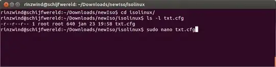

The menu options for the installer are stored in isolinux/txt.cfg and you can create new options in-between default install and label install.
This will create a new option called "Install Custom Ubuntu server" and it will add a kickstart file (the kickstart file is used to alter options; explained below):
label myownoption
  menu label ^Install Custom Ubuntu Server
  kernel /install/vmlinuz
  append  file=/cdrom/preseed/ubuntu-custom.seed initrd=/install/initrd.gz quiet ks=cdrom:/preseed/ks-custom.cfg --
  • myownoption is just a label you can use to identify your option.
  • "Install Custom Ubuntu Server" is the text that will show up in the boot menu.
  • If you want to make your menu option the default one, you only need to change the default install to default myownoption.
Example:
and editing the file (I used nano but if available use gedit, vim or another editor). Here is my addition to this file where I used "lampserver" as a label and my seed will be named "lampserver" too.
