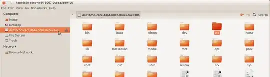

Here are the steps to do this graphically:
  1. Boot to a live Ubuntu environment using an Ubuntu bootable media;
  2. Start Nautilus file manager and mount your Ubuntu partition (here in the snapshot, it's the 129 GB Filesystem); snap1
    (Hit Ctrl + L to see the partition's UUID.) snap2
  3. Start Nautilus with root privilege (Press Alt + F2 and type gksu nautilus and hit enter); snap3
  4. The Ubuntu partition should show up in the side bar with its UUID. Click to mount it, and go to the /etc directory; snap4
  5. In /etc directory, scroll down to find the file named passwd- and make a copy of this in the directory (press-hold Ctrl key, place your mouse pointer over the file, press-hold the left mouse-button, drag the mouse pointer, and then release the mouse button followed by Ctrl key to make a copy in the same directory; a file named passwd- (copy) will be created); snap5
  6. Select the copy file, right-click and select rename. Then rename the file to passwd; snap6
  7. After the file has been renamed to passwd right-click and select Properties from the context menu, and in the tab Permissions set the appropriate permissions, i.e. the Owner root should have Read and write permission while for the Group and Others set the access to Read-only and close the properties window; snap7
  8. Now reboot your system and you should be able to log in with your password.
