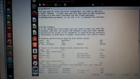

EDIT
ph_hba file:
here
Screenshot:

You are confusing the password for the Unix user "postgres" with the database password for the database user "postgres". These are not the same.
You've locked yourself out, because you enabled md5 authentication for database user postgres without setting a password for the database user postgres.
Add a new line to the top of pg_hba.conf:
local    postgres     postgres     peer
Then restart/reload PostgreSQL:
/etc/init.d/postgresql reload\
and run:
sudo -u postgres psql
From the resulting prompt:
ALTER USER postgres PASSWORD 'my_postgres_password';
remove the line you added to pg_hba.conf and restart Pg again. You can now use the password you set above to connect to PostgreSQL as the postgres user.
To learn more, read the "client authentication" chapter of the user manual and the docs on pg_hba.conf.
