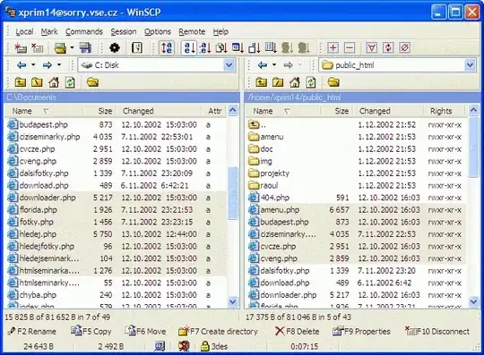

From a Windows client, use Winscp
http://winscp.net/eng/index.php
winscp

  • Is this installed on the host or client? – jfa Feb 18 '14 at 22:01
  • You run ssh on the server. Winscp is a small program and does not need to be installed at all, I personally run it from a flash drive, completely portable. sshfs is "built into" nautilus, no need to install anything on either Linux or Windows clinets. – Panther Feb 18 '14 at 22:06
