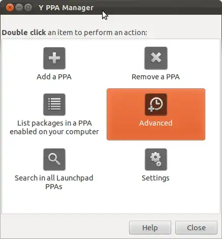

There is a tool called Y-PPA-Manager that lets you do exactly that.
To try Y-PPA-Manager, you need to run the following commands in a terminal:
sudo add-apt-repository ppa:webupd8team/y-ppa-manager
sudo apt-get update
sudo apt-get install y-ppa-manager
After installing, run the software and click on 'Advanced' button.
After clicking on that button, you would come up with a window similar to the one below. Click on 'Re-enable working PPAs after Ubuntu upgrade'.
You would then be prompted for your password. Enter your password and click OK. After that, you would get a dialog box like this:
Click OK and wait till all the working PPAs are re-enabled. When the entire process is successfully completed, you would be notified.
