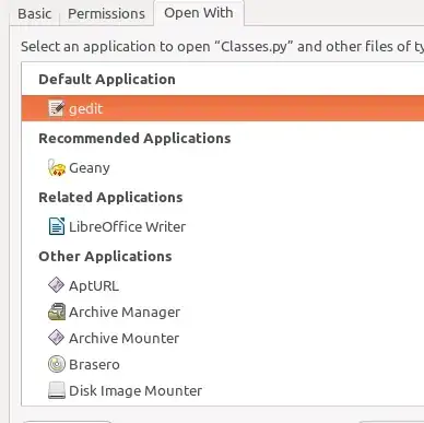

I have followed the instructions in this thread: How do I set IDLE as the default editor for Python scripts?, but it hasn't resulted in the option to open in IDLE being shown.
So I used the 'Find applications online' option in the 'Open with...' menu and installed SPE (Stanli's Python Editor) at it's recommendation, but the option to open .py files with that also isn't in the menu.
Does anyone have any suggestions? I'm running ubuntu 13.10 and am trying to use Python 3.3.
Thanks in advance.
Screenshots:
Option 1:
mimeapps.list
open with options
Option 2:
idle.desktop
more open with options

I had the same problem. This how I solved it:
  1. Uninstall idle from where you installed it.
  2. Install IDLE (using Python-3.3) from the Ubuntu Software Center. (It didn't work when I installed from Synaptic)
  3. Enter in terminal: gksudo gedit /usr/share/applications/idle-python3.3.desktop
  4. Edit file so it looks like this (exactly):
[Desktop Entry]
Name=IDLE (using Python-3.3)
Comment=Integrated Development Environment for Python (using Python-3.3)
Exec=/usr/bin/idle-python3.3 %F
Icon=/usr/share/pixmaps/python3.3.xpm
Terminal=false
Type=Application
Categories=Application;Development;
MimeType=text/x-python;
StartupNotify=true
Then it was visible in the menu for me.

  • Thanks for your reply! So, I did that, and from what I've read elsewhere, that's exactly what should do it, but for some reason not only is it not giving me the default, it's not giving me the option to open with it at all. I've edited my post to include screenshots. – Charles Clayton Mar 22 '14 at 07:08
  • I tested option 2 on a clean 13.10 system to set up Geany as my default python editor, it works. Please try this way. – Sylvain Pineau Mar 22 '14 at 14:17
  • Thanks once again for you help. I tried option 2 (see new screenshots) and it's still not giving me anything. Can you see what I'm doing wrong? I'm new to ubuntu and I'm starting to think it's just a lost cause. – Charles Clayton Mar 22 '14 at 17:16
