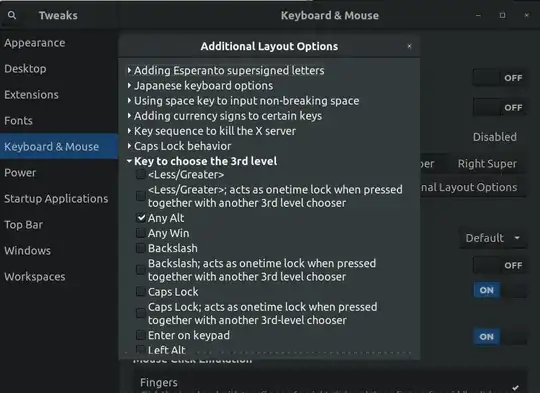

Ubuntu 18:04
gnome tweaks -> Keyboard & Mouse -> Additional Layout Options -> Key to choose the 3rd level -> Any Alt
Bruno Grieder

I know this question is old, but I found the answer fot it!
You simply have to open gnome tweaks -> Keyboard & Mouse -> Additional Layout Options -> Key to choose the 3rd level -> Right Alt never chooses 3rd level and your right alt works the same way left alt does.
If you really want a 3rd grade button you still can choose any other option like right win or menu button for example.
I personally like to use the menu button as my alt grade and it makes much more sense since I don't use this button.
