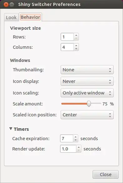

Almost done! We have a couple applet tweaks to make, if you decided to keep the Shiny Switcher and Garbage applets I suggested above so they're more like regular Unity. To enter the preferences for either applet, right-click it and select Applet Preferences from the pop-up menu.
Shiny Switcher Preferences
Check that the settings are the same as those pictured (the colors selected are #000000, 255):
Shiny Switcher Preferences Look
Shiny Switcher Preferences Behavior
