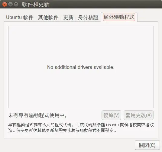

CPU          : AMD Athlon II X4 620
* "No additional drivers available" in "Additional Driver" page
