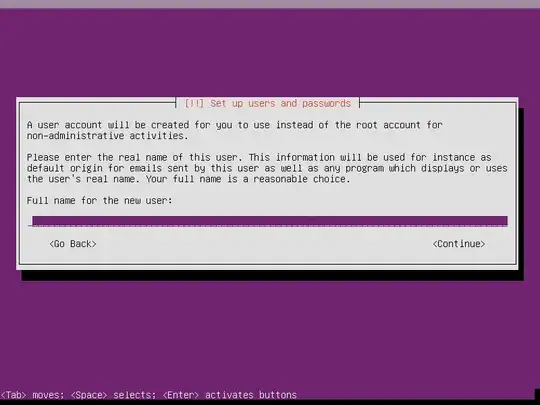

Give a Name, User name & password and it will later ask you to set the time.
