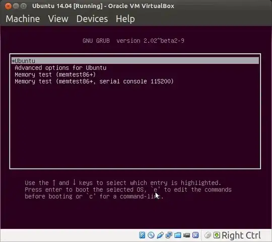

If after you install Ubuntu it will not boot to the desktop Hold down (right) SHIFT to display the menu during boot. In certain cases, pressing the ESC key may also display the menu you will get this screen boot menu then press the e key and go down to the line that starts with linux /bootvmlinuz after the words quite splash add nomodeset, then press F10 to boot.
After you boot if you had out of range issue's still follow the directions above for making the changes permanent in an installed Ubuntu desktop.
