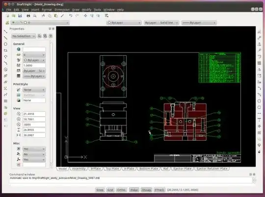

DraftSight. It doesn't cost money and they'll give you a nice .deb installer... but it's not open source or free software.
On the upside, it will also let you create and edit .dwg files.
