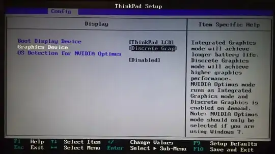

3) I made sure that in BIOS my 'Optimus' is disabled. As well I am using the open source driver, so I hope this is not an 'NVIDIA' problem, but a grub problem.

It seems that a solution has been found. 'oldfred' is the first to suggest a working solution. Thanks! I did a bunch of testing and ultimately this is what you need to do if you have this happen to you:
Using GParted I added back my swap partition. the swap partition is not related to this problem. As several people noted, the swap message was just the last line displayed on the screen when the OS froze.
To test if this solution works for you, when the purple grub screen appears press e to edit the entry. then add the following to the end of the line starting with Linux:
acpi_osi=Linux acpi_backlight=vendor
If this works for you, then to make this change permenant open your /etc/default/grub as sudo (sudo gedit /etc/default/grub)
change the string of
GRUB_CMDLINE_LINUX="no splash"
to
GRUB_CMDLINE_LINUX="no splash acpi_osi=Linux acpi_backlight=vendor"
- lastly get GRUB to load you new settings by typing
sudo update-grub
