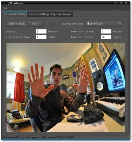

gTimelapse (Download Link)
An application for capturing images to generate timelapse videos, built on gPhoto2 and wxWidgets libraries.
Compile instructions
Download the source from the sourceforge website
in a terminal type the following:
cd Downloads
gunzip gtimelapse-0.1.tar.gz
tar -xvf gtimelapse-0.1.tar
cd gtimelapse
sudo apt-get install build-essential libgphoto2-2-dev libwxbase2.8-dev libwxgtk2.8-dev gphoto2
./configure
make
sudo make install
To run the application type
gtimelapse &
n.b. 1
gphoto2 --list-cameras | more
n.b. 2
see this blog for further useful info
lists all compatible devices that the application supports
n.b. 3
I've read the gphoto2 does not support webcams - I'll leave this answer visible anyway just in-case anyone wants to try this answer with a decent digital camera instead of a webcam.
fossfreedom
  • 171,546
  • 47
  • 376
  • 404
  • It took quite some time to fetch and compile wxWidgets with all the prerequisites. I also compiled gTimelapse but it just crashes with: [Debug] 13:21:12: ./src/common/menucmn.cpp(859): assert "item" failed in Check(): wxMenu::Check: no such item [Debug] Generating a stack trace... please waitTrace/breakpoint trap – Seppo Erviälä Jun 25 '11 at 10:23
  • ok - I'll have a go sometime today to build myself - I'll add some instructions to my answer (assuming I can myself get this to build). – fossfreedom Jun 25 '11 at 10:27
  • This is actually quite helpful since I have a digital camera supported by gphoto2. I didn't know a library like this existed. – Seppo Erviälä Jun 25 '11 at 16:56
