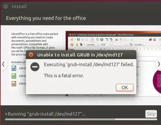

This machine have 2 128 GB SSD drives (http://www.amazon.com/dp/B00EPGHE0E/ref=twister_B00JYFOKKS).
I managed to install Ubuntu with no problems on one SSD drive, but I am having following troubles with RAID setup. Here is the details:
  • I boot from live USB (try Ubuntu option).
  • Install mdadm: sudo apt-get install mdadm.
  • Create RAID:
  • Run installer:
  • It fails to install GRUB:
I also tried to install grub manually after installer failed:
  • I looked how RAID is partinitioned:
  • Added BIOS Boot partinition:
  • Tried to install GRUB:
    $ sudo mount /dev/md127p4 /mnt
    $ sudo mount /dev/md127p1 /mnt/boot
    $ sudo grub-install --root-directory=/mnt /dev/md/127
    Installing for i386-pc platform.
    grub-install: error: diskfilter writes are not supported.
  • Tried solutions proposed in Diskfilter writes are not supported > What triggers this error? but still same error.

The BIOS boot partition(s) must be created on the disk(s) not the RAID device.
One BIOS boot partition is enough for you as your system won't boot with one disk only.
Linux soft RAID works on partitions, not drives. So you'll have to create one partition for the BIOS boot and one for the RAID.
You could have to create a third partition. /boot can be on RAID 1, can't be on RAID 5, and I'm not sure about RAID 0 but it probably can't.
