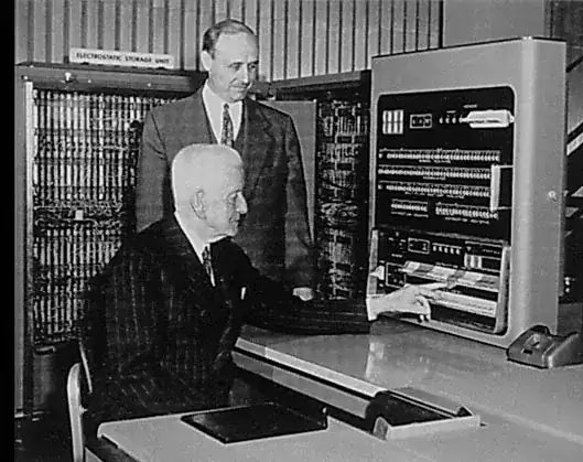

90
A visual representation.
Terminal
Something you can sit down at, and work like a boss.
Terminal
Console
Some hardware that does a bunch of stuff.
Console
Another example of a console, would be a video game console such as a Super Nintendo [where you can play Actraiser]

A Console is a special sort of terminal. It was also a physical device. For example in Linux we have virtual consoles, which we can access by a combination of Ctrl+Alt+F1 to F7.
Console sometimes means the keyboard and monitor physically attached to this computer.

Console refers to the (hardware) interfaces for the terminals. I.e. there are serial consoles and nowadays mostly virtual ones.
The window colloquially referred to as "console"-window is a shell, connected to a terminal of the system, via a virtual console.
Back in the day when computers were expensive a facility might have had one actual computer and several terminals connecting to it, via serial cables ("serial console"). The OS, operations, etc. were carried out on the physical Computer, input and output happened on the console(s).
You can switch between virtual terminals by pressing CTRL+ALT+F1(through to F6): a leftover of those times.
Today the concept of "thin clients" goes back in this direction of centralizing massive amounts of resources and providing just enough hardware to provide a state of the art interface at the actual workplace.
