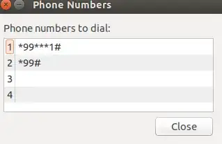

Now plugin your iball Airway device and wait for 15 seconds, then open gnome-ppp from unity dash board Gnome PPP Icon and click setup.
Follow the screen shots to configure Gnome-ppp.
enter image description here enter image description here enter image description here enter image description here enter image description here
System tray icon of Gnome PPP, after success full connection.
