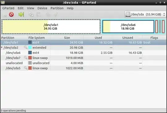

enter image description here enter image description here enter image description here
Tweak the /etc/fstab file
Remember I've mentioned that everything is a read-write operation as far as a computer is concerned ? Linux updates information about when a file was accessed, even if a file was accessed only for reading; that means the system makes an unnecessary write to disk. What if you'd want to minimize unnecessary writes ? Sounds like a reasonable thing, especially in SSD - the less writes, the longer it lives. To do that, add noatime,reatime words to your /etc/fstab file, in the line with configuration for your hard drive. Example is bellow (Note that in SSD drive, only noatime is needed,for more info read Arch Wiki):
