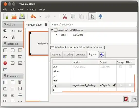

Glade Install glade
If you want a wysiwyg GUI designer, Glade is your best bet:
  • first, install glade from the software centre
  • create your GUI, save it as, say, myapp.glade
  • Go to the signals tab and set up your callback, such as on_window1_destroy
  • In your python program, tell GTK to load the UI definitions
     import gtk
     class MyApp (object):
         def __init__(self):
             self.builder = gtk.Builder()
             self.builder.add_from_file("myapp.glade")
             self.builder.connect_signals(self)
         def run(self):
             self.builder.get_object("window1").show_all()
             gtk.main()
         def on_window1_destroy(self, *args):
             gtk.main_quit()
     MyApp().run()
After getting everything set up, you can dive straight into the Glade tutorial (as Jeremy Kerr mentioned in his answer). Start by learning about the different lay–out options and signals.

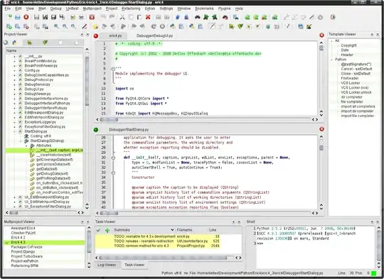

Eric IDE
Try with Eric IDE. I think it's the best IDE both for Python and Qt4.
Eric is a full-featured Python IDE written in PyQt using the QScintilla editor widget.
Some highlights:
  • Any number of editors with configurable syntax highlighting, code folding, auto indenting and brace highlighting.
  • Integrated Project Management facility to organize your projects. The project browser shows all source files, all forms and all translations each on its own tab. The source browser has built in class browsing capabilities.
  • Integrated and full featured debuggers for Python and Ruby.
  • Interactive shells for Python and Ruby.
  • An explorer window for walking through your directory structure with built in class browsing capabilities for Python files.
  • Variable windows that display local and global variables in the current scope while debugging a program.
  • An integrated interface to the Python Module "unittest".
  • An integrated help viewer to display HTML help files. Alternatively you can choose to use Qt-Assistant to view help files.
  • Display of the UI in different languages.
  • The capability to start Qt-Designer and Qt-Linguist from within eric5.
  • The ability to compile Qt-Designer forms, to produce Qt-Linguist files and release them from within the IDE.
To install Eric IDE in all currently supported versions of Ubuntu open the terminal and type:
sudo apt install eric
Eric IDE
