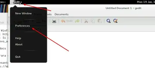

I have 14.04, but gedit over there has an option to change color scheme --- the preferences menu is quite hidden (at least in gnome-shell), you have to go on the panel menu to find it:
finding the preference menu entry

If you want to change just the color of the highlight line (for example), you should edit the style; in principle that should be easily done by changing the file
/usr/share/gtksourceview-3.0/styles/kate.xml
(reference here) and change the line
<style name="current-line"                background="#EEF6FF"/>
to your liking. Unfortunately, it doesn't work --- if anyone know why please chime in.

  • @SethLee, I too have just the 3.0 version and `gedit` ignores me completely. Finding the preferences was complex --- I use gnome and you can only find them under the panel menu (will add a shot). But if this another configurability that gnome decided to take away, my only solution is to change to another editor, as I did (using `vim`/`gvim` now, but `kate` or `geany` are quite good too). – Rmano Jan 19 '15 at 17:51
