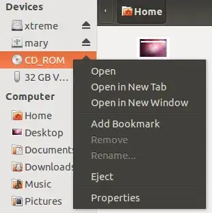

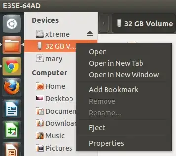

Here are some pics that show what you can see when you try to disconnect the device:
As you can see in this image, a Pen Drive / Flash Drive has the "Eject" option enter image description here

An external USB DVD Drive has the "Eject" option
Unity Launcher showing an "Eject Parent Drive" option on a multi-partitioned Pen Drive (Has 2 partitions in this case) enter image description here
A 2 partition created pen drive
