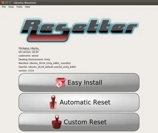

Introduction:
Resetter is a tool which is used to reset Ubuntu installation to factory default. The Ubuntu system will go back to the state when it was installed for the first time. It finds all applications which are installed after Ubuntu fresh installation and delete them. Not just applications, it also deletes the users too. Deleting users means deleting their home too which means all user files and configurations. You don't have to install everything from the beginning. Just reset your Ubuntu to its factory defaults and start installing everything else.
Installation:
Download the latest release of Resetter and add-apt-key_versionX.deb from GitHub or use
wgetto direct download. At the time of posting this answer v3.0.0 was the latest release. To download usingwgetuse:wget https://github.com/gaining/Resetter/releases/download/v3.0.0-stable/resetter_3.0.0-stable_all.deb wget https://github.com/gaining/Resetter/releases/download/v3.0.0-stable/add-apt-key_1.0-0.5_all.debInstall some dependencies:
sudo apt install libqt5clucene5 libqt5designer5 libqt5help5 python3-psutil python3-pyqt5 python3-pyqt5.qtsvg python3-sipInstall downloaded .deb packages:
sudo dpkg -i package1.deb package2.deb
Using Resetter:
Open Resetter from Dash and authenticate. Authentication is required to perform administrative tasks.
To reset Ubuntu, click on Automatic Reset. But if you want to remove multiple packages at once click on custom reset.
Click "Yes" to confirm. You'll get a dialog which would list all the packages which would be removed.
Click "OK" to start. The factory reset will begin:

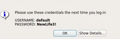

A new user will be created to access the system using administrative privileges. A dialog will appear which would show details about that newly created user. After that confirmation for Reboot will appear.
If your Ubuntu boots into TTY mode (command line/console mode), login with the credentials of new user and install desktop environment again.
sudo apt install ubuntu-desktop sudo rebootUse previously provided password to login.
