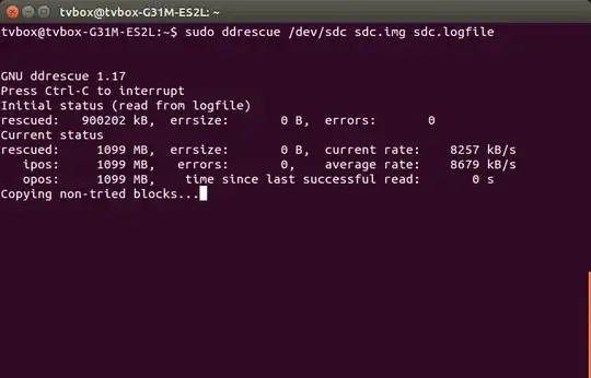

Make an image of the offending device with ddrescue - You will require enough storage space to hold the entire drive regardless of the amount of data you have (or had) stored on it in this case it appears you'll need 16GB to store a clone of /dev/sdb.
ddrescue is the program that will be doing the work and if it's not installed we need to install it with sudo apt-get install gddrescue (not a typo, the g is short for GNU)
Open a terminal with CtrlAltT and change to the directory that you will be storing the image file in and issue the command sudo ddrescue -d /dev/sdb sdb.img sdb.logfile
the -d directs direct access to the drive (ignoring caching) /dev/sdb is the device we are using for input sdb.img is the file we are using for output sdb.logfile is keeping track of where we are and what our results are.
If for any reason the process is stopped before completion, the logfile allows picking up where we left off.
imaging will begin and you will see something like this:
ddrescue
Rescued indicates the amount of data successfully read, errsize indicates the size of unreadable data. As the process continues we hope to see the former increase and the latter approach zero. ddrescue uses a process called data carving as I recall in which failed blocks are halved and re-tried.
ddrescue is a very powerful tool and you can learn a great deal about it in the manual. Pay close attention to Chapter 3!! choosing the wrong file or device for output will definitely ruin your day.
After we have the resulting image we can run tests and recovery procedures on it without any further stress to the failing or failed device.
Eventually ddrescue will output "Finished" to the terminal screen. If the errsize is high and you feel like you might want to try to recover a little more you can re-run the command and apply switches to re-try failed blocks and even read in reverse (likely not helpful on a solid state device) by: sudo ddrescue -d --try-again --retrim --reverse /dev/sdb sdb.img sdb.logfile or any other combination of switches you think might be helpful in the aforementioned manual. Once you've finished attempting to recover all the data, it's time to see what we have.
