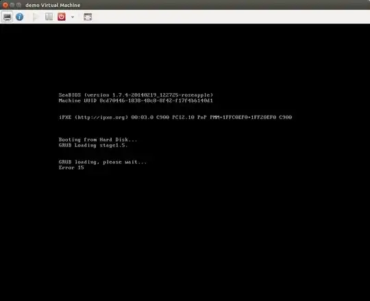

60
I haven't tried this command on Ubuntu (for obvious reasons) so I am not sure if Ubuntu will allow its execution.
I did. rm -rf / --no-preserve-root was running in a root session opened directly on the machine, while I was also connected through ssh from another machine, using the root account as well.
What happens is that you start to get a lot of messages like:
rm: cannot remove '/...': Operation not permitted
or:
rm: cannot remove '/...': Device or resource busy
Surprisingly, ssh connection remained opened until the end of the operation. It's only when I closed the connection and tried to reopen it that a error appeared:
Read from socket failed: Connection reset by peer
On the machine, four directories remain:
  • /dev. This is where device files are stored.
  • /proc—in-memory filesystem created by the kernel.
  • /run, a standardized file system location for daemons.
  • /sys. This allows you to get information about the system and its components.
This means that there is not much left, and not much to do there. You can't ls (although when using Tab, the names of directories and files are still displayed). You can cd in different directories, and also echo stuff, but commands such as cat are not available any longer.
There is no sudo either.
shutdown -h now and reboot disappeared as well, so your only option seems to turn the machine down manually. Logout (exit) doesn't work, even if it shows a nice "logout" text.
Once you try to reboot the machine, you're presented with a nice GRUB error 15, and then, nothing happens, at which point you may start thinking that your rm might have done something bad to your system.
