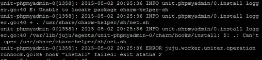

juju debug-log --replay
wordpress:
phpmyadmin:

But when I go to my MaaS server where juju is installed:
juju resolved --retry wordpress/0
and so I went again to the node where wordpress is installed to check why is not working:
juju ssh 2
su
It works if I add export http_proxy=http://root:redeslinux@172.16.1.160:3128/ but when I close the wordpress node PuTTY, and open the MaaS server PuTTY and do juju resolved --retry wordpress/0 gives hook failed install.
What to do, to make export http_proxy=http://root:redeslinux@172.16.1.160:3128/ permanent in the wordpress node or similiar?

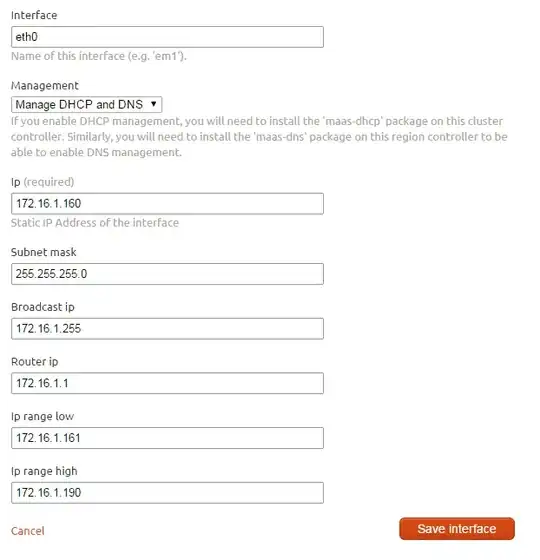

I assume by charm store you are referring to the website? I'm almost sure that Squid is overkill.
I see that machine 0 uses your proxy successfully. I can also see that the default route of machine 0 is 172.16.1.1, but the default route of the MAAS host is 172.16.1.2. It is set up incorrectly in the MAAS web interface, as you show in your screenshot. Change the "Router" configuration in the MAAS DHCP website to 172.16.1.2, and re-try

  • I think not. How do I configure that? – Mario Apr 26 '15 at 15:27

  • I changed the router ip to 172.16.1.2 and it still gives the ppa:charmers/charm-helpers error because it cannot add the ppa, any tips? – Mario May 01 '15 at 19:20
