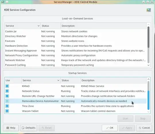

I tried also the second suggestion from user26687, starting the service via: kcmshell4 kcmkded.
Indeed, the service was not running!
After starting the service via button start, it mounts directly my devices.
But after a system reboot, the service is not starting automatically.

The 'Removable Device Automounter' Service, another KDE(4) control module, needs to be running. Check with:
$ kcmshell4 --list | grep kcmkded
kcmkded                    - KDE Services Configuration
As default the Removable Device Automounter is not running by default, open the windows and start the serice:
kcmshell4 kcmkded
KDE service manager windows

  • Thanks for your suggestions, it works a **little**....But after system-restart, the service is not running anymore. – Ben Apr 30 '15 at 11:55
  • Wow, thanks for your strong support! i will try ASAP. – Ben Apr 30 '15 at 18:48
  • i am back again, After changing **phase** from **1** to **0** it works! Thank you. – Ben May 04 '15 at 06:54
