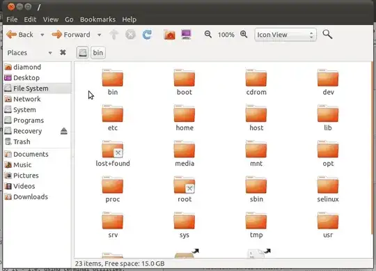

A malware pops up http://ad.adsmatte.com/<random string> and annoys me every time i click on a link. It has also denied me access to youtube. The youtube page is completly disoriented and doesnt play any video. I tried to reinstall the chromium browser and all, but they were futile. My browsing speed has also declined. Please help! Below is how youtube is displayed! enter image description here

  • I have added picture to this question. Have a look. – V Sree Harissh May 20 '15 at 06:16
