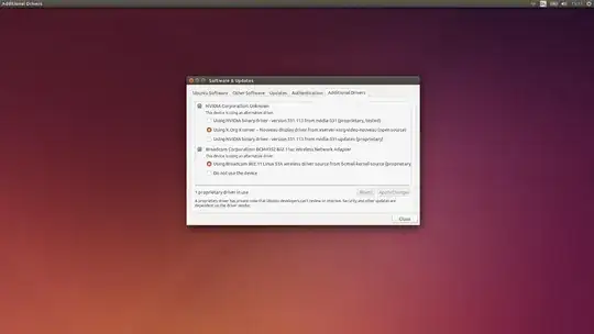

I probably need other drivers than I currently use. My current setting looks as follows:enter image description here.
I selected the "proprietary, tested" version once and it then says that I use the recommended driver. However, when I then booted again, I could still enter my password but after logging in, I could not do anything (ctrl+alt+T did not open a terminal, there was no bar on the left anymore). I could get back to the current status by following the instructions made by Marco Scannadinari. Now I am not sure how to get the appropriate drivers for my graphics card. I run:

Edit: I do not think that is a duplicate since it is not clear yet what the cause of my problem actually is. I already tried different drivers which did not solve my problem.If someone told me "The problem is that you use/installed the wrong drivers which can be seen from the screenshot you posted so you need to follow the instructions in the link Fabby provides to install the appropriate drivers" it would already be helpful. But even then it is hardly a duplicate.
