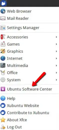

You can use a program called convert included in the imagemagick package. It is command line driven, but very easy to use. Install it either through the software center, or go to a command prompt and type
sudo apt-get install imagemagick
Now to create the .gif.
