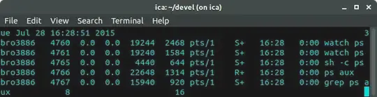

I have managed to reduce the issue down to a single line. When running
watch "ps aux | grep 'ps aux'"
in a terminal, you usually get several lines of output, as is expected.
output showing 5 results
Note that the top three lines are cut off, and just barely fit ps aux at the end. When you reduce the size of your terminal to where it does not fit any more, it is cut from the results completely.
output showing 2 results
This means that grep only receives the cut off output. What I find most baffling about this is the extremely limited scope for which this happens. It does not happen for either of
ps aux | grep "ps aux"
watch "ps u -C ps"
watch "ssh localhost 'ps aux | grep \"ps aux\"'"
In all of these cases, the list wraps around as expected.
This seems to be the case for both bash and sh, on Ubuntu 15.04.
While I managed to work around this issue in my script, does anyone have an explanation for this behavior?

  • I can''t reproduce on my machine. `watch "ps aux | grep 'ps aux'"` wraps as expected. There does seem to be an issue with `watch` only showing limited output. You might be interested in my question here: [Does watch only monitor the visible output?](http://unix.stackexchange.com/q/101041). – terdon Jul 28 '15 at 09:27
  • Reproducible here, but at a much narrower terminal width than in your screen shot. And lo and behold! then they _reappear_ at a yet narrower width. Nasal demons with a twist. – zwets Jul 28 '15 at 11:31

Indeed, setting the COLUMNS variable manually helps:
COLUMNS=2000 watch "ps aux | grep 'ps aux'"
