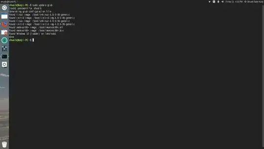

Found a better workaround. Just go to the boot menu in your bios and and set the "Ubuntu" bootloader to #1 priority(i.e. move it up the list of boot devices till it reaches the #1 in the list). Save the settings and exit. It should boot Ubuntu now or more likely show you the GRUB menu. If in the GRUB menu your Windows 10/8 bootloader is not listed(highly unlikely), don't panic. Just boot into Ubuntu, open the terminal and run
sudo update-grub
This is what my system shows: terminal It should list the Windows 10/8 bootloader in the GRUB menu now. Hope that helps.
P.S. This workaround only works if you have ONLY ONE HDD/SSD on your machine.
