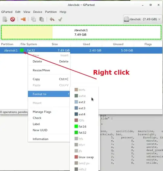

To use gparted (short guide because How to format a USB flash drive? has a video --- I hate that...)
After started gparted, remember to (1) choose the right device (triple check, and then again) and (2) unmount it if mounted (you can say it's mounted because then option like partition, format, etc are dimmed):
gparted1
then create a partition table if needed:
gparted2
and create a big partition with Partition->New. Choose (1) a primary partion, the (2) right type, and if you add a label in (3) this will be the name of the device when automounted.
gparted3
...and then format it:
gparted4
Notice that gparted will not do all the operation instantly. It will create a list in the bottom window...:
gparted5
...and to really do it you have to choose Edit->Apply all.. :
gparted6
... you're done!
