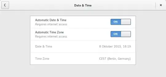

This question shows how to stop automatic time update (and switch to manual):
How to stop automatic time update?
I want to do this exact thing but I can only ssh onto my machine so I need to make this change through the terminal. Is there any way to do this?

74
GNOME Automatic Date & Time doesn't use the ntp service, installable via sudo apt-get install ntp. Therefore stopping or uninstalling the service doesn't help.
Systemd timedatectl is used, therefore one command to switch off
timedatectl set-ntp 0
and one command to switch on
timedatectl set-ntp 1

  • Thank you! This is exactly what I was looking for. This is the setting that is changed when you switch between manual and automatic in the System Settings – GeneralAsh Oct 08 '15 at 16:27
