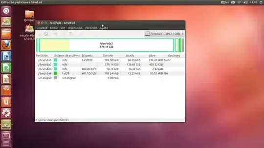

Why don't I have this option?
here's my disk layout
sudo fdisk -l
Disk /dev/sda: 640.1 GB, 640135028736 bytes
255 heads, 63 sectors/track, 77825 cylinders, total 1250263728 sectors
Units = sectors of 1 * 512 = 512 bytes
Sector size (logical/physical): 512 bytes / 512 bytes
I/O size (minimum/optimal): 512 bytes / 512 bytes
Disk identifier: 0x5b53cc54
   Device Boot      Start         End      Blocks   Id  System
/dev/sda1   *        2048      409599      203776    7  HPFS/NTFS/exFAT
/dev/sda2          409600  1153767021   576678711    7  HPFS/NTFS/exFAT
/dev/sda3      1216962560  1250050047    16543744    7  HPFS/NTFS/exFAT
/dev/sda4      1250050048  1250261679      105816    c  W95 FAT32 (LBA)
Disk /dev/sdb: 4005 MB, 4005527552 bytes
32 heads, 63 sectors/track, 3880 cylinders, total 7823296 sectors
Disk identifier: 0x20d8782d
/dev/sdb1   *          63     7822079     3911008+   c  W95 FAT32 (LBA)

The ubiquity installer offers to Install inside Windows when it cannot install alongside. i.e. when you already have 4 primary partitions used. This means that splitting the Windows partition is not possible.
If you select this option, it copies wubi.exe to the Windows Startup folder, so that when you next boot Windows it will automatically run Wubi.
Since you don't want to install with Wubi, you'll need instead to remove one of the primary partitions, and try installing again.

  • Indeed, it seems to be I have 4 primary partions. That is the answer to my problem. – Stein Mar 24 '13 at 22:03
  • I guess you will have to use WUBI after all :) – Ahmadgeo Mar 24 '13 at 22:08
  • @Ahmadgeo you don't *have* to use Wubi. You just need to remove one of the partitions. This is actually very common to have OEM-installed computers shipped with 4 partitions used. – bcbc Mar 24 '13 at 22:10
  • @bcbc; The problem with OEM partitions is that they are either small in size, or are Recovery partitions so I -personally don't like to mess with :) – Ahmadgeo Mar 24 '13 at 22:19
  • @Ahmadgeo right. I don't like it either. But if you want Ubuntu (and not with Wubi or a VM) then there's no choice. – bcbc Mar 24 '13 at 22:39
