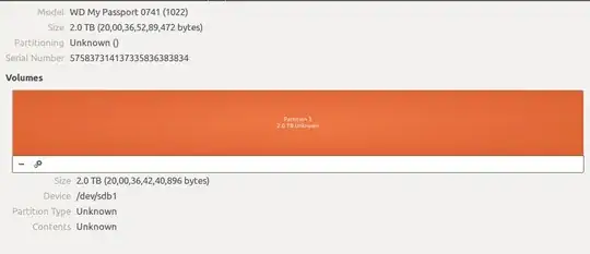

  1. Here is how it shows up on the Disks application
    screenshot of Disks

  • can you [edit] your post and post the output of this command`sudo fdisk -l` – Neil Nov 09 '15 at 23:23
  • Your unknown Partitioning must be something Windows specific, maybe something like "dynamic partitions". What does Windows say about it? – ubfan1 Nov 10 '15 at 00:41
  • What's the output of `sudo blkid /dev/sd1`? – David Foerster Nov 10 '15 at 12:10
  • @Neil - posted the output of `sudo fdisk -l` – 3l4ng Nov 11 '15 at 10:56
  • @DavidFoerster - I assumed you meant `/dev/sdb1` which is the external HDD, However, neither `sudo blkid /dev/sd1` nor `sudo blkid /dev/sdb1` gave any output. I did get `UUIDs` and `PARTUUIDs` for my internal HDD `/dev/sda`. Do you want me to post them? – 3l4ng Nov 11 '15 at 10:58
  • @ubfan1 - the HDD was working fine with Ubuntu up until a few days ago. – 3l4ng Nov 11 '15 at 10:59
  • @3l4ng: I meant the first partition of your internal drive. It just turned out to appear at path `/dev/sdb1` in the Gnome Disks screenshot at the top of your question. – David Foerster Nov 11 '15 at 14:06
  • @DavidFoerster - thank you for the clarification, but there was no output either way. What does this indicate? – 3l4ng Nov 11 '15 at 17:26
  • I'm not sure. I don't have a plausible explanation, that covers 1) Windows being able to read the file system, 2) `fdisk` reading the partition table without complaint, and 3) none of Gnome Disks, `blkid` and the NTFS driver recognizing the file system header. My best explanation is an issue with the USB stack between the external drive case and your Linux system. – David Foerster Nov 11 '15 at 21:35
  • I recommend to look for issue reports about drive cases with the sam USB ID (which you can find out with `lsusb`). – David Foerster Nov 11 '15 at 21:42
  • @DavidFoerster - was able to mount manually. However, cannot get automount working. Please see point #6 – 3l4ng Nov 19 '15 at 07:10
