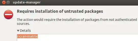

From command line, after entering sudo apt-get upgrade I get
WARNING: The following packages cannot be authenticated!
  r-cran-matrix
Install these packages without verification [y/N]?
Alternatively, from Task Manager, I get

You actually have two separate issues, and they are not related to each other, they're individually different issues.
The first is the r-cran-matrix issue, designated by the E:... line in your output. The GPG key used for the signatures of that repository are no longer valid and expired. You need to refer to the location of how you installed that repository to readd it and update the keys.
The second is you have two entries for Dropbox, denoted by the two W:... lines in the output. Check all your sources.list file and your files in /etc/apt/sources.list.d/*.list for duplicate entries for Dropbox. It looks like you have two entries that match based on that error.

I'm really confused because I have no idea how dropbox and cran would be connected, but I just did sudo gedit /etc/apt/sources.list and removed both lines with dropbox in them and now sudo apt-get update works fine. No worries about dropbox as I'm not using that anymore.
If anyone can post a relatively canonical answer, I'll be happy to give credit for that.
