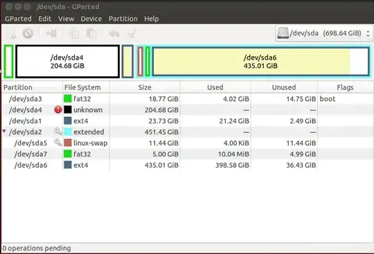

Image of gparted
Update
I tried following the instructions at the site you mentioned by markkirby, but it seems nothing was actually copied over to the HD. I made the partition ext2 and set the mount point as / without formatting the partition. Gparted is reporting the partition as ext2, but it says the partition is empty and it still can't boot. Looks like my last option is to format the partition and risk loosing whatever data was on the partition that also stored the OS.

  • Can you give a screen shot of gparted on a live usb ? Would really help to see if you Ubuntu is installed or not. Don't ever let Windows `repair` anything, it thinks it is the only OS in the world and messes with everything. You can reinstall Ubuntu and save your home folder, see http://askubuntu.com/questions/269880/re-install-ubuntu-without-losing-data-in-home-folder – Mark Kirby Dec 04 '15 at 14:09
  • @markkirby Trust me, I know. I was afraid something like this would happen, but by the time I noticed it was running the disk repair I was afraid stopping it would cause damage regardless. Anyways, I updated my post to include a link to the gparted image. – c1moore Dec 04 '15 at 16:12
