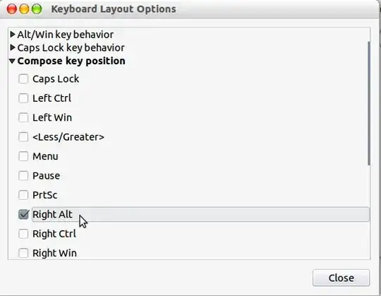

In Ubuntu 12.04 LTS:
  1. Select System Settings... from system menu; snap1
  2. Select Keyboard; snap2
  3. Under the tab labelled Typing click Layout Settings; snap3
  4. In keyboard layout window, click Options... button; snap4
  5. Finally in the Keyboard Layout Options window select Key(s) to change layout and mark the binding of your choice. (I use Shift + CapsLock to toggle the layout.) snap5
