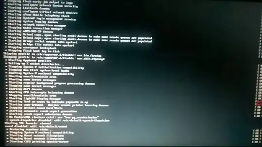

This is the output on pressing Esc:
kernel output

A random thought made me try unity -v which told me that unity wasn't installed.
$ sudo apt-get install unity and I got to the login screen. Here I couldn't get in despite entering the correct password.
By following the steps given here I entered sudo apt-get install ubuntu-desktop and managed to login.
A few programs that were previously installed are now missing but I managed to login successfully without losing any files.
