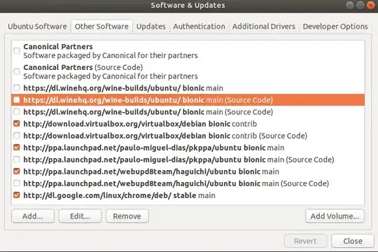

It seems that single enabled repository failing to update will cause this message. In my case, it was dl.winehq.org/wine-builds/ubuntu/bionic - I unchecked and no longer get error messages.
Ben Creasy
  • 234
