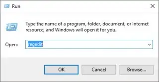

One final method
This is only good for GUI programs, like Chrome, Firefox and Gedit. However, it also means you don't have a terminal lying around - which you could accidentally close. It's no good for sudo apt-get install program or similar, because you can't type your password after running it.
Press Alt + F2, and a "Run Dialouge" appears - a bit like the run window on Windows:
Ubuntu:                                                                                    Windows:
You can type any command into here, and it will run it!
