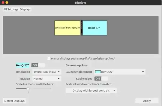

All windows opens on left monitor and all new files gets saved there, I want my right monitor as my primary monitor so all this happens there.
As the picture below shows I have set the launcher on my right monitor but that doesn't help with my problem.

I had this same problem, as well as several other problems related to having multiple monitors.
It turns out this is an open unsolved bug for Ubuntu; meaning the solution link posted in the above comment does not actually contain a solution that fully works. See open bug report here: https://bugs.launchpad.net/ubuntu/+source/xorg-server/+bug/1425000
Fortunately I spent a bunch of time figuring out how to configure this as well as the orientation of the login screens but that's explained in a different thread (I have four monitors and login orientation was wrong but it's all sorted now, if you also have this issue see solution here: Where does Unity/Unity-Greeter Load X Configuration From?)
The quick simple solution to the problem of not being able to set your default display, and/or the default display getting reset after reboot is to put a short shell command that changes the primary monitor as one of your "Startup Applications" which will automatically run every time you log in (this should work for any recent Ubuntu running the Unity display manager which is the default display manager and probably other DMs but I didn't test that):
