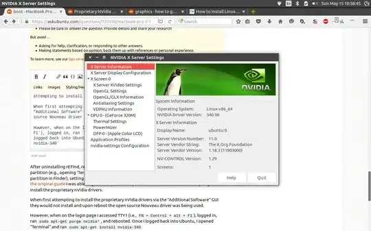

After uninstalling rEFInd, reinstalling Ubuntu so that the "ubuntu" folder appears in the EFI partition (e.g., opening 'Terminal' on OS X, running sudo mountesp and then viewing the EFI partition in Finder), setting the Grub menu (as detailed here) and following the instructions in the original guide I was able to get the expected outputs of 08 and 07 before attempting to install the proprietary nVidia drivers.
When first attempting to install the proprietary nVidia drivers via the "Additional Software" GUI they would not install and upon reboot the open source Nouveau driver was being used.
However, when on the login page I accessed TTY1 (i.e., FN + Control + alt + F1), logged in, ran sudo apt-get purge nvidia*, and rebooted. Once I logged back into Ubuntu, I opened "Terminal" and ran sudo apt-get install nvidia-340, then sudo apt-get update, followed by sudo apt-get dist-upgrade, and then rebooted.
This resulted in a successful start-up of Ubuntu 16.04 LTS on my MacBook Pro (7,1) in a dual-boot configuration (OS X 10.11.4 El Capitan) utilizing Grub as my boot loader.
Screenshot
Thank you to the guides linked herein and @mikewhatever for helping me address this issue. Hopefully this will help others who may encounter similar issues.
