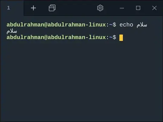

There are three more solutions:
  1. use tabby (an electron app - web based):
  1. use Konsole (the default emulator for KDE distros):
    sudo apt install konsole
  1. use butterfly (a pure web based terminal):
thank you @singrium
Flimm
  • 40,306
  • 94
  • 154
  • Terminus was renamed to Tabby. It actually doesn't support Arabic at all any more. At least it didn't when I tried it just now. – Flimm Feb 23 '22 at 14:30
