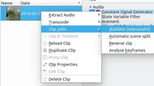

I have a shaky video that I would like to stabilize with Kdenlive. However, I can't seem to get it to work. I right-click a clip in the project bin and select Clip Jobs -> Stabilize, but nothing happens.
I am using Kdenlive 15.12.3 on Ubuntu 16.04. What am I doing wrong?

    A [bug](https://bugs.kde.org/show_bug.cgi?id=360440) has been reported for this. – chaskes May 30 '16 at 01:40
    I think I found the bug and I submitted a patch upstream. We'll see where that goes. – Nathan Osman May 30 '16 at 07:07
    Good news! [My patch was accepted.](http://commits.kde.org/kdenlive/96d863093774b4ec0ddaac69dfb0fd6c2a11732a) – Nathan Osman Jun 04 '16 at 21:06

This is a bug in Kdenlive 15.12.3. However, there is a newer version of Kdenlive out: version 16.04.1. This is the latest version of Kdenlive and the developers of the application have patched this bug in this version.
This should solve your problem. Good luck!
  • How is that possible? This problem was still present in the Git repository three days ago... – Nathan Osman Jun 01 '16 at 19:19
  • That's weird, I just googled around and a few websites have said that the bug was fixed in the latest version. –  Jun 01 '16 at 22:54
You have to update your kdenlive version. To check your current version type in terminal:
kdenlive --version
To update your version
sudo add-apt-repository ppa:kdenlive/kdenlive-stable
sudo apt update -y && sudo apt upgrade -y
sudo apt-get install kdenlive -y
I had the same problem with 15.12.2 on Ubuntu 16.04. After reading here what TheChosenOne99 said, I made an update in Terminal (look here: https://kdenlive.org/download/) and the stabilization works now.
