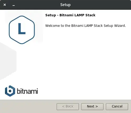

  • Download the recommended installer from here : https://bitnami.com/stack/lamp/installer
  • Provide execution permission to the *.run file that you download
    chmod +x bitnami-lampstack-xxx-xxx-xxx.run
  • Run it. (Just double click on it or run from terminal : ./binnami-xxx.run)
  • The installation processes is self explanatory.
